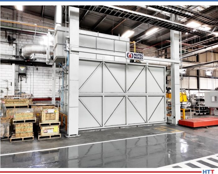

(photo source: Nutec Bickley)
We offered an ideal option, enabling the client to take on a single supplier to supply all of this equipment and to have it delivered it as a turnkey project.

A high temperature convection oven (1,110°F/600°C) with nitrogen injection
  • Equipped with stainless steel baffles to direct gases into the chamber and achieve the required temperature uniformity
  • Equipped with a thermal incinerator to reduce VOCs

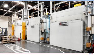

12 Low-Temperature Convection Ovens (390°F to 660°F/200°C to 350°C)
  • Two of them with forced cooling using extractors
  • Two of them with an incinerator to burn the volatile gases being vented to the atmosphere, greatly reducing pollution emissions
  • The other equipment was adapted to install more incinerators in the future.
  • Steel paneled ovens and mineral wool insulation
  • Design of baffles to direct gases into the chamber and achieve the required temperature uniformity
