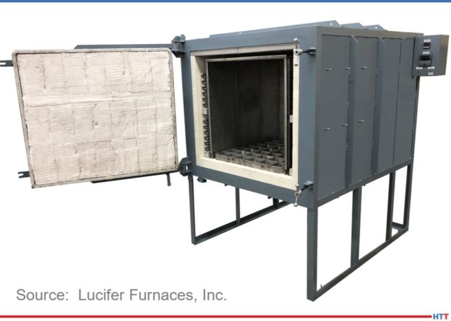

4000 Series Oven from Lucifer Furnaces
The 4000 series oven from Lucifer Furnaces is a Model 42-T36 and has a chamber size of 30″H x 30″W x 36″L, heating to 1200°F with 35 KW of power.
This model is complete with a high CFM rear mounted fan assembly to recirculate the heated air uniformly throughout the chamber. A stainless-steel liner isolates the heating elements from the work area and directs air forward over the heating elements and back through the chamber in a horizontal pattern for uniform heating.
The horizontal swing door is lined with lightweight pyroblock insulation with a ceramic fiber gasket to reduce heat loss around the chamber opening. A safety microswitch automatically shuts off power to heating elements and fan when door is opened, eliminating electric shock and heat blast hazards to oven operator. Controls include a Honeywell digital time proportioning temperature controller accessorized with a high limit controller for safety in the event of a high temp excursion.
